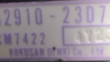

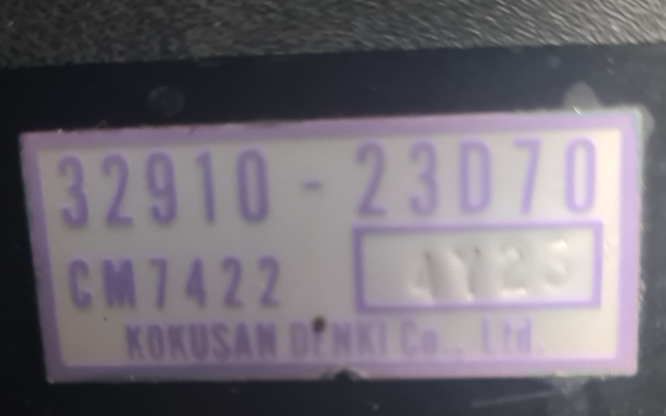

  • Das Bild ist nur das Zündmodul. Da gibts keine Unterschiede glaube ich.
    Deine SAPC ist da interessanter!
    Danke , das Modul ist also Serie.
    Was willst Du wissen? Eine Nummer die drauf steht? Wo finde ich das Teil?

  • das ist die korrekte SAPC für die LD01:
    1. 22d10... used in the RGV250 SP. Has a bit more advance than the others and a different switching for the two solenoid valves.
    2. 22d30... This box only opens the pilot air valve between 500-2000 rpm, and is the most common un-restricted SAPC box available. [edit 2012 - sean] Found the following using an electronic input.
    Test Cycle 1200rpm
    smooth opening from closed to mid across 7300-8000 rpm
    Full open at 9900rpm
    3. 22d60... restricted box (only provides 45bhp).
    4. 22d90... German market box (anti pollution laws), but it's comparable to the 23d00, but the switching of the pilot air system stop in "neutral", 5th, and 6th gears.
    5. 23d00... another German model, opens the pilot air valve between 2k-6k rpm, the advance and the switching of the main air solenoid valves is the same as the 22d30.
    6. 23d70... Aprilia ignition box.Thought to be derived from the 23d10, but most likely a tweaked 22D30 - not seen much difference on dyno except a slightly weaker top end and stronger midrange than the 22D30
