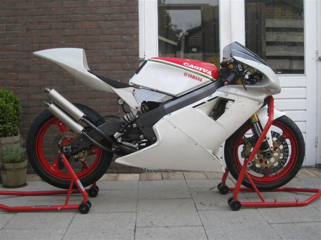

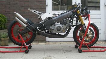

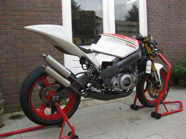

paßt vielleicht ganz gut dazu, hab ich gerade auf der igk seite gesehen. (kenne den typen aber nicht)
Mito 350
For sale Cagiva Mito 2-cilinder 2-stroke.
Build in 2003, completely rebuild in 2008 with;
370cc Yamaha RD350 YPVS engine:
• K&N airfilters
• 34mm mikuni carbs
• V-force membranes
• Wisico forged pistons
• Completely programmable ignition, powervalve and quickshifter (software included)
• Exhaust gas temperature sensors (KOSO)
• Dashboard with many functions (speed, 2 temp sensors, max rev, etc, etc.)
• PS tuning exhausts
• Completely titanium silencers
• Modified clutch
• ABS transparent clutch cover
• 68 hp at back wheel
Frame, Cagiva Mito Racing (very rare)
• Suspension modified bij Grizzly Racing Service
• Marchesini wheels
• Michelin Power Race Soft tires (used 1 day)
• Subframe made from aluminium sheet metal
• Fast throttle handle
Fairing:
• Cagiva Mito SP 525 fairing
• Honda RS125 ’08 seat
• MRA windshield
Extra:
• Some chainwheels
• New spark plugs
• Some jets, needle jets etc.
• Engine(s) or parts
• Etc.
Bike is registered as 2-cilinder soa can be made street-legal with some lights.
I will sell the bike because it has not been used for quite some time.
Price 3500 euro
http://www.mito350.tk
