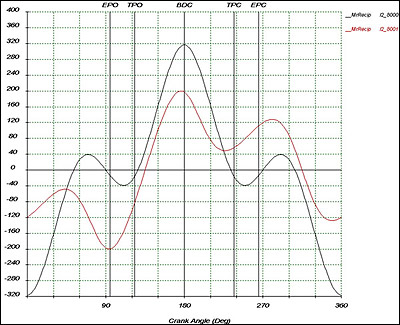

(4): Comfort on long road rides, and better ‘feel’ of controls when racing = less fatigue - more enjoyment.TSS500LC and TSS500GP Crank Layout Options
Further, we are offering our cranks in a choice of 180° or 90° firing orders. The 90° layout in a parallel-twin offers a reduction of peak rocking-couple forces of 31%, which is one of the reasons why KTM’s Technical Director Harald Bartol has chosen this layout for his team’s 250 FRR GP bike.The diagram below shows a 180° crank layout in the black trace and a 90° layout in the red trace. Here the lower rocking-couple peak forces inherent in the 90° layout can clearly be seen.
Please note that the Rocking-Couple Peak Forces are independent of the crank’s Balance Factor. The Balance Factor is all about balancing the crank assembly precisely to match the reciprocating components, i.e. the piston/pin/rod etc, whereas the Rocking Couple relates to, in the case of a 180° parallel twin, the violent oscillation of the engine to the left and then to the right as opposing pistons reach TDC and BDC simultaneously.
Whereas, in a 90° crank configuration, a higher inertial momentum (flywheel effect) can be maintained about the crankshaft by having one piston always at or near maximum velocity while the other one comes to a ‘stop’ and then changes direction. The pistons are never both ‘stationary’ at the same time.
This ‘flywheel effect’ also allows the use of smaller actual flywheels.Therefore a 90° layout will always give the crank an easier life, and accordingly crank life will be extended. This is particularly important for racing applications.
Another advantage of the 90 degree crank layout is that, just as in the GP world, the 90 degree Big Bang gives better feel and grip from the rear tyre on corner exit due to the longer duration of No Driving Force.
This becomes a serious issue, especially with an RS500 race bike with 115HP driving not much more than 100kg.
A tyre is only capable of a total grip factor.This is expressed as a "traction circle" and the shape of the circle is turned elliptical, fore and aft, under acceleration or braking.
This use of the longitudinal acceleration or braking traction capability then proportionally reduces the traction available laterally, i.e. side grip.
So Big Bang gives more available side grip as the accelerative force is applied to the tyre in shorter duration bursts, i.e. 90/360 instead of 180/360. "

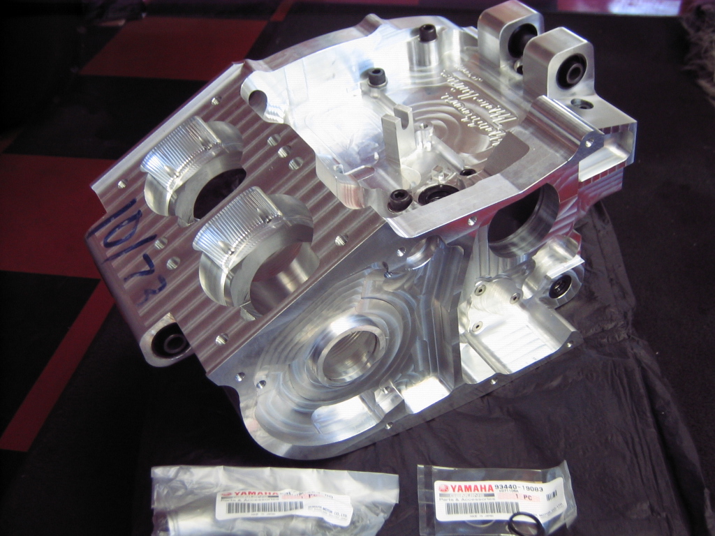

paar fragen, hat die TSS500 nun ne ausgleichswelle oder nicht ?
Ist das im Bild der KR1 da rechts die Ausgleichswelle ?
und, ist nun 90° besser oder nicht ? (wurde ja schon oft thematisiert)
Ausgleichswelle? Woher denn...die TSS läuft mit RD350YPVS-KW-Gehäuse, da passt keine Ausgleichwelle rein.
