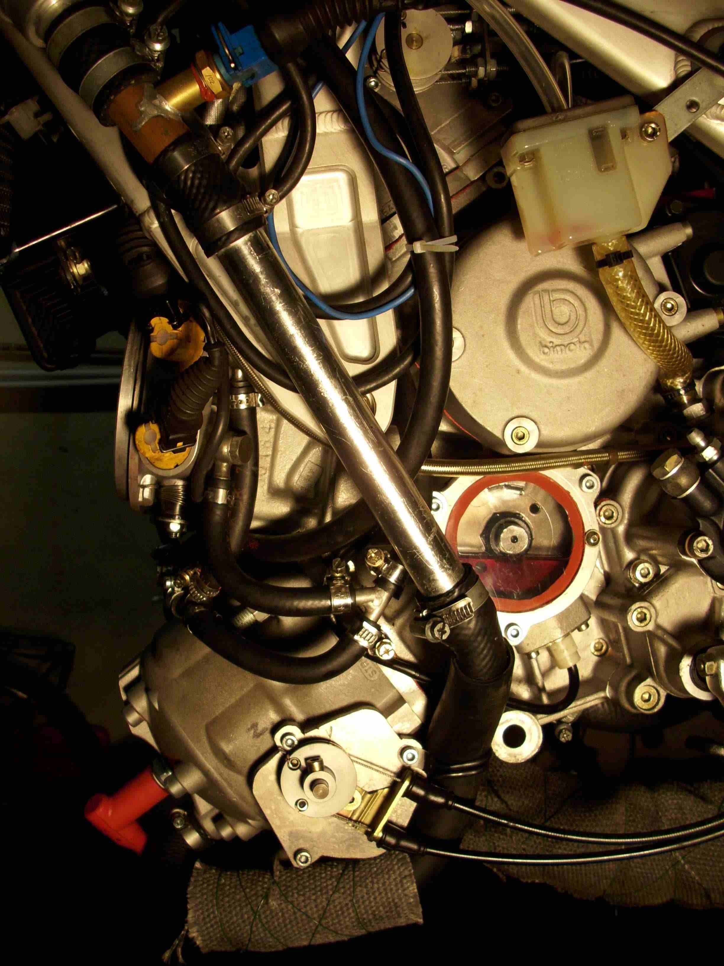

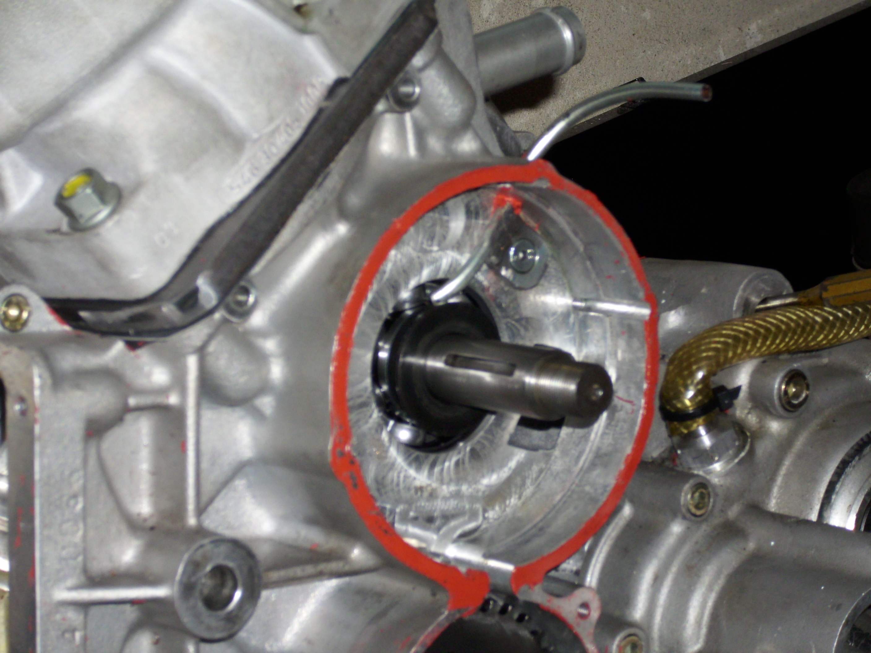

  • Finally i finished disassembling the engine, updated with the latest pictures today. Please let me know if there is anything you would like to see pictures off, i will keep adding pictures whit mods etc.. when i start to reassemble the engine/bike.

    About crankshaft:
    interesting would be total pic and a better one for the seal area.
    What diameter does the crankshaft have?

  • lubrication is thru the the crank and rod into the crankcase were it is mixed with the gas.
    I will try to take more pictures of the crank and the seal area later. Regarding the other subjects i will look at that later when i assemble the engine.
